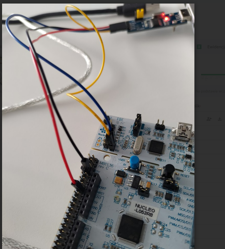

Take photo of your UART to USB and your board connection

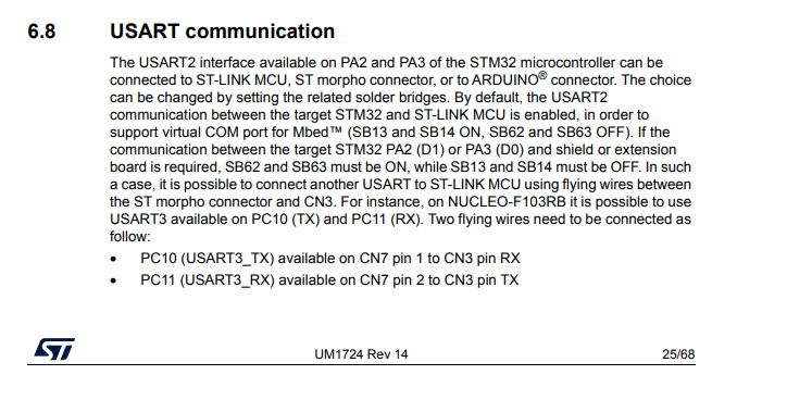

In case of USART2. look at board manual:
try using CN3 connector:
