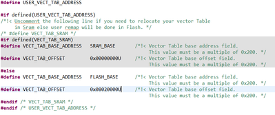

Did you set the vector table according to that new address?
Did you update the linker file according to that new address?
2025-05-16 6:15 AM
Yes i done these steps:

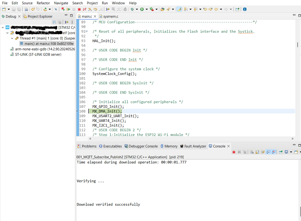

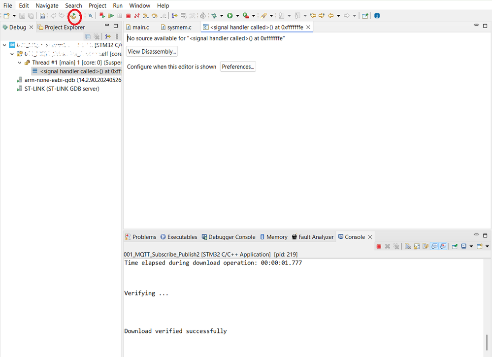

2025-05-16 11:44 PM - edited 2025-05-17 12:23 AM
Another thing to note:
In debug mode, when I hit "Resume", the code runs as expected.
But if I hit "Reset", it doesn't run and shows a message like “No resource preset” or gets stuck.

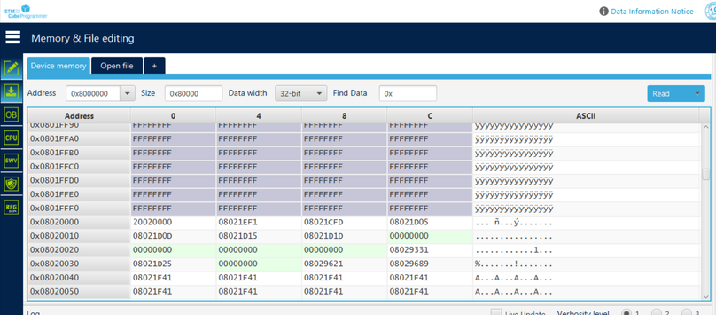

FYI:
I placed the code succesfully @sector5 (i.e., 0x08020000) , but it runs only once , after reset it doesn't run.
2025-05-17 2:11 AM - edited 2025-05-17 4:55 AM
Dear @Shreayas_Acharaya ,
You can not boot at sector5 on this product, impossible , it is hardware coded to either Flash sector 0 or ST system memory boot .
So, if you want to do that , you need to program a Jump code from Sector 0 to sector 5, therefore programming First boot sector at 0x0800-0000. When using debugger , the debug is forcing that jump automatically but this will not happen at standalone after cold reset.
