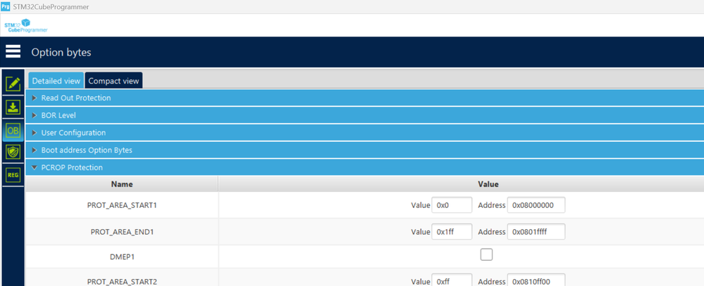

After tinkering around a bit to understand its functions, I can no longer reset its protection to its default state. Currently, it looks like the one in the photo:

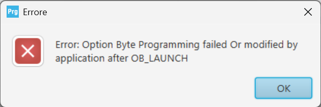

When I try to set these values
PROT_AREA_START1 = 0x0801FF00
PROT_AREA_END1 = 0x080100FF
which i believe are their default values, both in the RDP=0xAA and RDP=0xBB states, I get this error.
How can I fix this? Is there a way to reset PCROP Protection to its default mode?

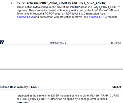

Hello @Domy_ST ,
yes, you can reset the PCROP, but only when the RDP is changed at the same time:
Which means that you need to set the RDP to 0xBB and then, in the same step, request both RDP=0xAA and the PCROP modification.

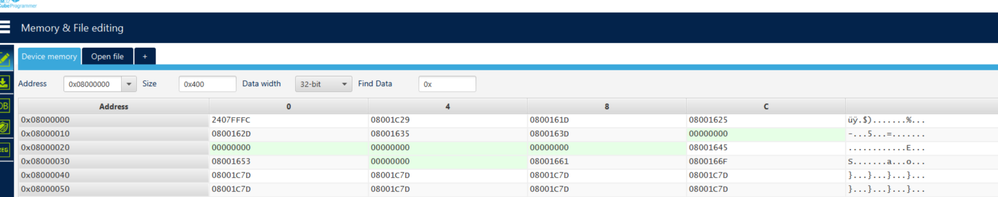

Here's the sequence of how I write data to that flash area, again using the STM32Cubeprogrammer tool:
  • I load from a binary file, and that area is populated as shown in the following figure:

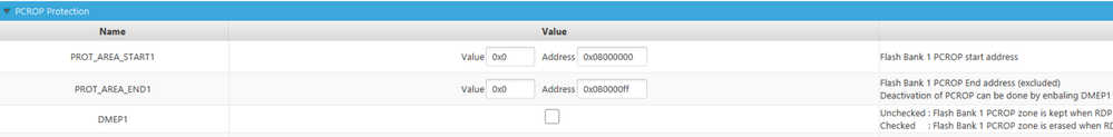

  • I enable PCROP only for that area of ​​sector 0, as shown in the following figure:

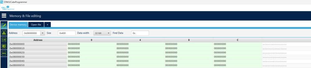

  • After that, I reread the data in that flash area. I see that we're all zero, as shown in the following figure:
Is there a way to prevent it from returning zero, but instead return data from binary files as before, but still need to be protected by PCROP during the regression from RDP = 1 to RDP = 0?

the very purpose of PCROP is to return zeros when being read. The fact that it's not erased during regression is secondary. Maybe you can try using secure area instead? It may be better fitting your use case.

To add on what  @Bubbles  said, PCROP is a security mechanism, its purpose is to protect a proprietary code from being read (leaked) or altered. It sets a memory region as execute only by the CPU. All other types of access including data read, write and erase operations are strictly prohibited. So external access to that region via DMA or debug interface is blocked.
