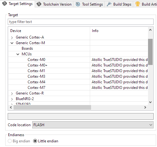

I know TrueSTUDIO is tagged as obsolete, but I like to use it.
The STM32H5 use Cortex-M33 core, then how to add M33 support?
I already upgraded TrueSTUDIO to support GCC 10.3.1 and recent loaders and SVD files. It would be nice to use M33 cores with TrueSTUDIO...
