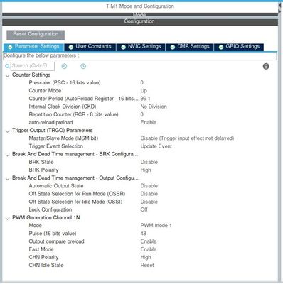

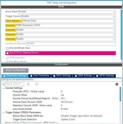

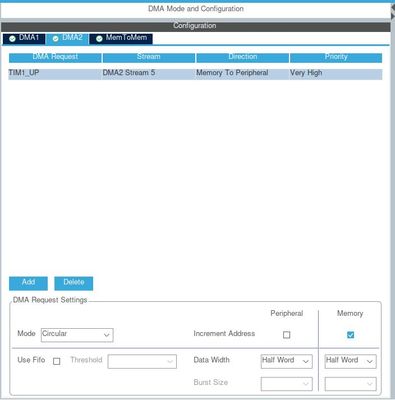

I have tried DMA1 config as Memory to Periperal with Timer 4 config as PWM gen using its Update Event to transfer data byte to GPIO Port A but that didin't worked. I debuged and found that Timer PWM was working but it doesn't trigger DMA or may be some problem with DMA1.
Than, I tried DMA2 config as Memory to Periperal with Timer 1 as PWM gen using its Update Event to transfer data half word to GPIO Port A used complimentary output as DAC CLK and that worked. But unable to go more than 1MHz (Ticks = 96) as I go lower (Ticks = 72) I didn't even got PWM Output.
Here is the code:-
int main(void)
HAL_Init();
SystemClock_Config();
MX_GPIO_Init();
MX_DMA_Init();
MX_TIM1_Init();
/* USER CODE BEGIN 2 */
HAL_DMA_Start_IT(&hdma_tim1_up, (uint32_t)pypoints, (uint32_t)&(GPIOA->ODR), 100);//Interrupt Ensure that data is transfered
HAL_TIM_Base_Start_IT(&htim1);
HAL_TIM_PWM_Start_IT(&htim1, TIM_CHANNEL_1);
HAL_TIMEx_PWMN_Start_IT(&htim1, TIM_CHANNEL_1);
TIM1->DIER |= (1 << 8);// set UDE bit (update dma request enable)
/* USER CODE BEGIN WHILE */
while (1)
/* USER CODE END WHILE */
/* USER CODE BEGIN 3 */
/* USER CODE END 3 */

2024-02-26 5:27 AM
Thanks for your reply.
I am using STM32F411CEU6 and configured the TIM1_CH1 to trigger DMA2 to transmit data through GPIO. The TIM1 is just generating a PWM signal for the output clock of 10MHz. I have put all pins in GPIOA so I can use a half-word data width on PSIZE and MSIZE data width is a byte with FIFO Enabled (Full Threshold).

htim1.Init.AutoReloadPreload = TIM_AUTORELOAD_PRELOAD_DISABLE;
if (HAL_TIM_Base_Init(&htim1) != HAL_OK)
Error_Handler();
sClockSourceConfig.ClockSource = TIM_CLOCKSOURCE_INTERNAL;
if (HAL_TIM_ConfigClockSource(&htim1, &sClockSourceConfig) != HAL_OK)
Error_Handler();
if (HAL_TIM_PWM_Init(&htim1) != HAL_OK)
Error_Handler();
sMasterConfig.MasterOutputTrigger = TIM_TRGO_UPDATE;
if (HAL_TIMEx_MasterConfigSynchronization(&htim1, &sMasterConfig) != HAL_OK)
Error_Handler();
sConfigOC.OCMode = TIM_OCMODE_PWM1;
sConfigOC.Pulse = 5;
sConfigOC.OCPolarity = TIM_OCPOLARITY_HIGH;
sConfigOC.OCNPolarity = TIM_OCNPOLARITY_HIGH;
sConfigOC.OCFastMode = TIM_OCFAST_ENABLE;
sConfigOC.OCIdleState = TIM_OCIDLESTATE_RESET;
sConfigOC.OCNIdleState = TIM_OCNIDLESTATE_RESET;
if (HAL_TIM_PWM_ConfigChannel(&htim1, &sConfigOC, TIM_CHANNEL_1) != HAL_OK)
Error_Handler();
sBreakDeadTimeConfig.OffStateRunMode = TIM_OSSR_DISABLE;
sBreakDeadTimeConfig.OffStateIDLEMode = TIM_OSSI_DISABLE;
sBreakDeadTimeConfig.LockLevel = TIM_LOCKLEVEL_OFF;
sBreakDeadTimeConfig.DeadTime = 0;
sBreakDeadTimeConfig.BreakState = TIM_BREAK_DISABLE;
sBreakDeadTimeConfig.BreakPolarity = TIM_BREAKPOLARITY_HIGH;
sBreakDeadTimeConfig.AutomaticOutput = TIM_AUTOMATICOUTPUT_DISABLE;
if (HAL_TIMEx_ConfigBreakDeadTime(&htim1, &sBreakDeadTimeConfig) != HAL_OK)
Error_Handler();
/* USER CODE BEGIN TIM1_Init 2 */
/* USER CODE END TIM1_Init 2 */
HAL_TIM_MspPostInit(&htim1);
* Enable DMA controller clock
static void MX_DMA_Init(void)
/* DMA controller clock enable */
__HAL_RCC_DMA2_CLK_ENABLE();
