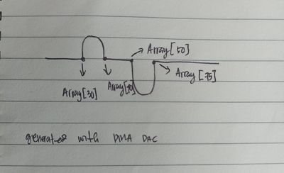

A signal is generated by a DAC DMA used on the STM32F405. Using a buffer containing an array [100]. As shown in the picture, the point (circle on the line) represents the point to be detected. This is only for detection, not to start and stop the signal.
In short, I want to detect when the array [45] "starts ignition detection" and array [50] "stops ignition detection". However, I'm still trying to figure out how to detect it because the DMA will directly generate the signal without me knowing exactly where it forms the array [45].
Do you have any suggestions or ideas on how to achieve this?

But I want the counter data or array, not the sampling time.

@macam1 are you using a timer to trigger DMA for each sample generation? for example using TIM2 and activate the 4 channels interrupt for output compare (with no output). Each channel will be specific to a array[x] position detection. As you have 4 values to detect, you need 4 channels as I said previously. And for each TIM Channel you need to compute the pulse value in a manner an interrupt will be raised when the TIM counter reaches a value that corresponds to array[x]. in that case you will treat the occurrence of the array[x] positions in the TIM interrupt output compare.
I don't know if that works but you need to test it.
