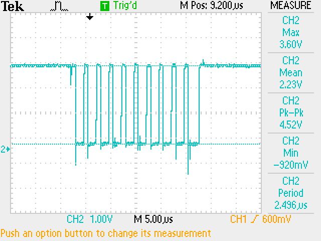

The first image is a captured message. The blue line is the SCL while the yellow one is SDA. The cursor lines repesent the baselines of each signal. Clearly the SCL stays within the correct values while the SDA low level is way to low.

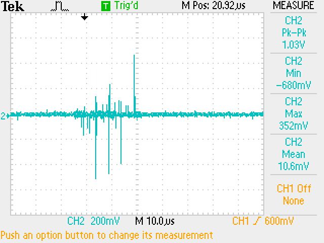

The second image is the ground level corresponding to the message above.

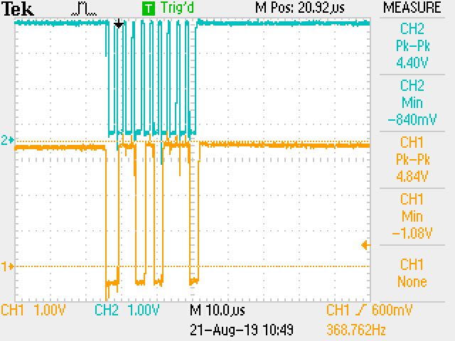

The next image is a close up of the data signal with some meassurement values.

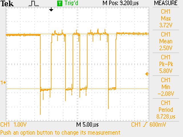

The last image is a close up of the SCL with the same meassured variables as image number 3.
