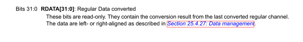

2025-10-11 5:34 AM
>Now the question is, how do I get more than 16 bits of resolution?
So use oversampling , but no right shift. Then you get all bits...16+7 = 23 b here.
And read full data register, 32b.
2025-10-12 6:58 AM
Thank you very much, it worked this time, although I have tried every combination of bit-shifting and buffer sizes and whatnot before, but it would not give valid results, and now I have found out why.
It was the Clock source!
For some reason, at the beginning of development, I ended up using the PLL3R for my ADC clock source instead of PLL2P, and apparently, that was the culprit for invalid reads.
While using PLL3R clock source values above 25Mhz of ADC clock would create wrong results, by shifting to PLL2P I can use 50Mhz for ADC clock with great results.(I'm aware of the fact that in the LQFP100 package, using ADC clock above 18 to 19MHz will have missing codes in 16-bit mode, I'm just experimenting.)
