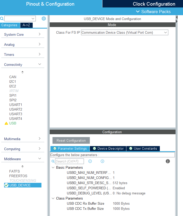

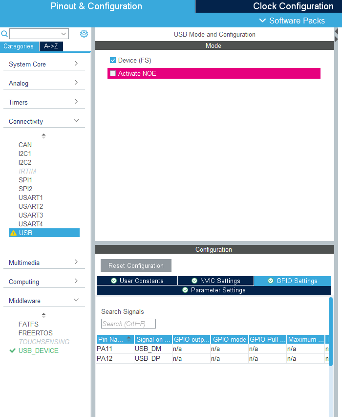

1) Connectivity -> USB -> Device (FS) box checked
2) Middleware -> USB_DEVICE -> Class For FS IP -> Communication Device Class (Virtual Port Com) option selected

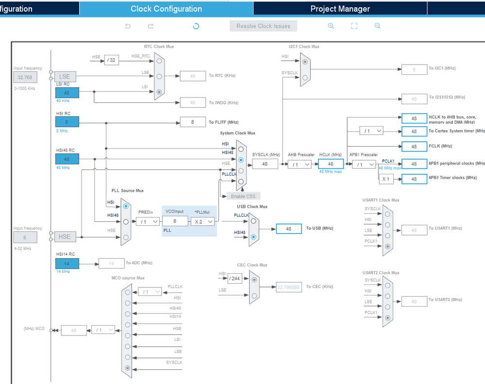

3) Here's my clock configuration

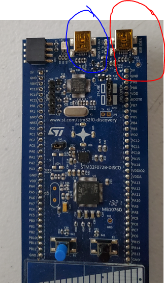

5) I use the ST-LINK port on my board (circled in blue) to flash the code, and once the code has been flashed I unplug the cable from the ST-LINK port and insert it into the USB USER port (circled in red). It is at this moment, when the cable is connected to the USB USER port that I can see my little controller under PORTS in the device manager, and I can then connect to the serial monitor and I will see the message displayed.
