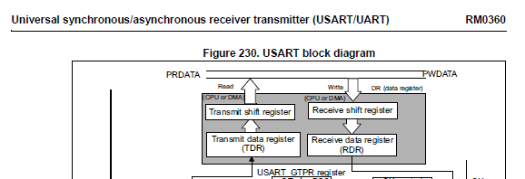

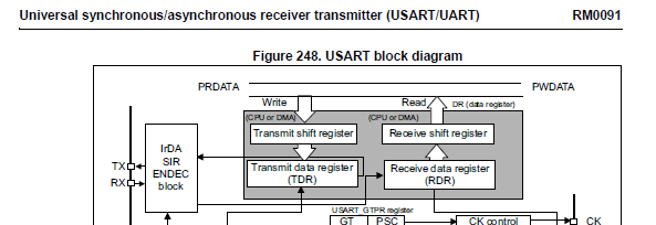

2024-03-20 11:52 AM
Looks like the same mistake is repeated in many RMs; eg,
2024-03-20 12:07 PM
Hello @Andrew Neil
We will check other RMs too. And we will be grateful for all your contributions.
Best Regards.
STTwo-32
