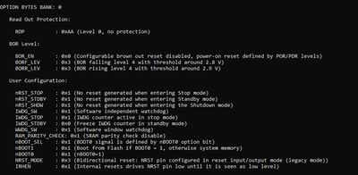

Independent watchdog is enabled in the firmware flashed in the process mentioned above. With option bytes, we had only modified the IWDG_STDBY bit to 0. Rest of the option byte configurations are kept as it is.

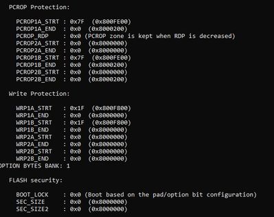

Attaching the screenshot of the complete output of option bytes read command.
