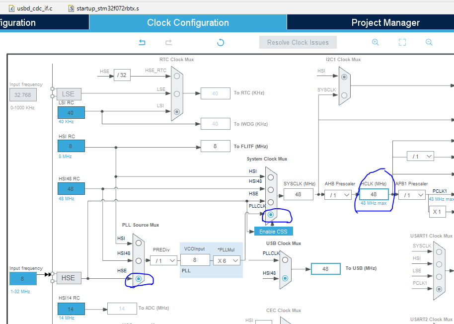

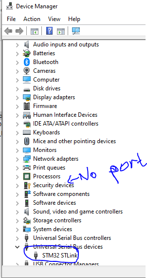

My STM32F0 won't show up under "Ports " in my device manager. It does, however, show up under "Universal Serial Bus Devices". I'm trying to print to a serial monitor. I've spent over 12 hours (low guess) trying to troubleshoot this issue. Here is what it looks like in my device manager.Here are some of the settings I've tried
I did also try using RCC as Crystal/Ceramic Resonator
What do I need to do so I can get my device to show up as COM 4 or COM 6 or some other COM channel?

The "STM32 STLink" device showing up is the ST-Link debugger chip, not the STM32F0 chip.
What hardware are you working on and how exactly is it hooked up? In addition to getting the USB driver firmware working, you'll need to connect to the chip directly through the USB pins.

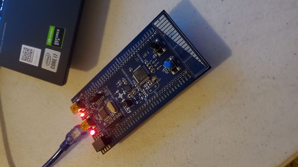

Here's my setup. Pretty basic, just trying to get this part to work before moving on.
Do I need additional hardware to make this work? Do I need to connect to the other micro-usb slot? (actually just tried that and it didn't seem to work when I plugged it in).

The "USB USER" port is connected to the target chip, so yes, you need to use that one. The "USB ST-LINK" is connected to the ST-Link chip.

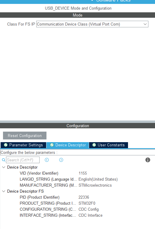

Alright so yes it's been a while since I've looked at this problem again because it was frustrating me. I tried your suggestion once before that I needed to use the usb user connection, but it hadn't worked. Today I again just tried to enable the USB as Device (FS), and then the USB_DEVICE as Communication class VCP, and then connected to the usb user connection on the board and it worked. I remember doing that before, but now it's April so it makes sense that it works now, you know how it goes :face_with_tears_of_joy:
