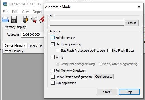

If you use a ST-LINK, you can try with STM3 ST-Link Utility => Menu Target => Automatic Mode...
You can check "Run application"
