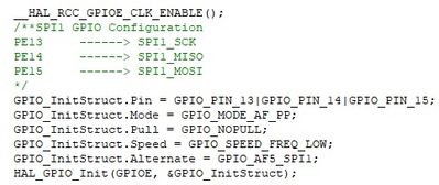

This is my 2nd ST account. I use SPI1 port for both STM32U585 (Master - SPI Polling mode) and STM32U5G9 (Slave - SPI DMA) boards.
Pin config:

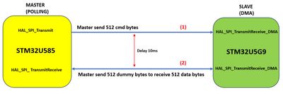

Flow chart:
The flow chart is shown above, but currently the master cannot receive data from the slave in response (2). Do I need to disable - enable DMA every time I call the HAL_SPI_TransmitReceive_DMA function?

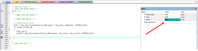

Hi Kaouthar,
When I debug on the slave side (STM32U5G9) the return status of the second call to HAL_SPI_TransmitReceive_DMA is HAL_BUSY. I think the delay time between two calls to this function is 5 ms which is enough to finish a transmit - receive process.
The test code of both master and slave is attached below. Please show me anything innormal in these test code
Thank you.
Duong

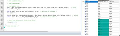

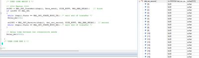

2024-10-07 9:19 PM
Hi Kaouthar,
On the master side if I do as below then no data will be received in dat_rec_second buffer:
But if I do as this then data will be received in dat_rec_first buffer and not in dat_rec_second buffer.
Is there any problem in the way I implement on the master side?
