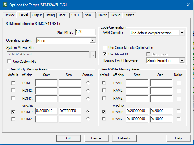

So, first I went to the flash options in KEIL uVision and set the IROM to 0x0800_0010, instead of 0x0800_0000 (below)

I then compiled and loaded the program, but it does not run. Opening the ST-LINK Utility and connecting to the device shows that the program is loaded at 0x0800_0010 (below).
So, changing the #define for the FlashBase doesn't work and I don't understand exactly why.
