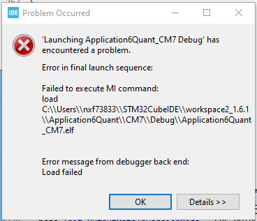

I manually added the section and linker attribute to put the activations array 16MB into the external ram, since 16MB is plenty for everything else. With that, the project compiled. However, when I try to download the project to the board, it fails immediately. The error is not helpful: When trying to download the .elf file to the board in the STM32CubeProgrammer, I get a different error that is similarly not helpful:
" 16:01:58 : Error: failed to download Segment[3]
16:01:58 : Error: failed to download the File"

Well pretty sure it doesn't download into SDRAM directly, code in startup.s should bring that up and copy content.
To program the External QSPI memory you'll want to specify that it needs to use the appropriate External Loader
ie MT25TL01G_STM32H747I-DISCO.stldr

Looks like you're building code, might want to look at .MAP or .ELF to understand where "Segment[3]" is situated, but guessing 0x90000000 for QSPI, for the tools to download'n'debug you'd need to specify the External Loader in the CubeIDE user interface

I am left with no further information on how to actually write to the qspi flash. I really don't understand how I am supposed to do it. I figured the download tool in the IDE should be able to handle it no problem. Do you have any more insights or recommendations?
