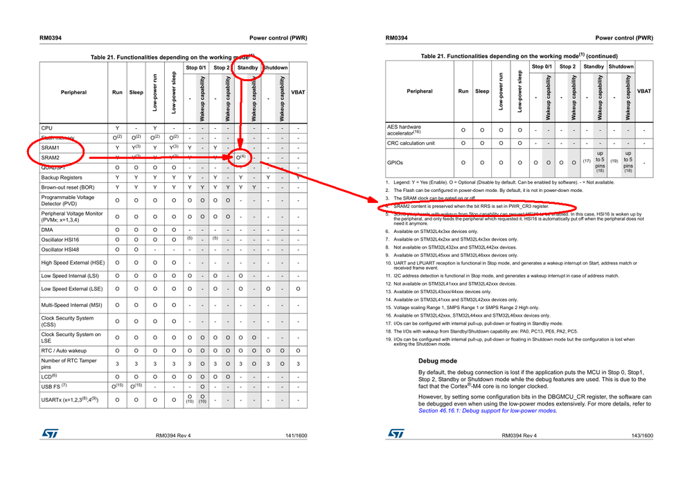

Thanks for the response. I have used the default hal function HAL_PWREx_EnableSRAM2ContentRetention() before entering standby mode to set the register as mentioned in reference manual . But still iam not able to preserve the contents and wakeup using RTC . Any other settings required for this?

2021-07-20 12:01 PM
Make sure var is located in SRAM2, and that the startup code does not overwrite it.
