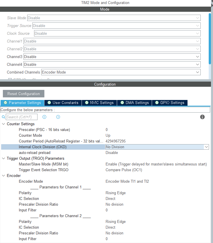

I am using the STM32F303RBTx MCU and currently have a quadrature (4x) encoder set up on TIM2. You can find my STM32CubeMX configuration settings below:

I tried setting up a slave timer (TIM15) to synchronize with TIM2 (master timer), using Compare Pulse as the Trigger Event Selection (TRGO), but so far I'm having no luck with this.

Thanks for the prompt reply! Would the encoder pin have to be directly connected to this IC timer, or can it be triggered internally? If internally triggered, am I correct to use Compare Pulse as the TRGO? OCxREF can't be used because my encoder (TIM2) is configured as an input timer, not an output.

If you want to use the internal master-slave connection, then yes, in TIM2 you use the incorrectly named Compare Pulse setting for TIM2_CR2.MMS. However, you won't be able to measure pulse *length*, as in this setting TRGO is taken from after the edge detector and is only one pulse long. You can still infer frequency from signal period, i.e. capture of successive edges of the same direction.
