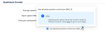

Hey,
thanks for your answer. I made some tests and realized, that everything is working fine, if I dont activate the I(Z) Channel, meaning absolute position control. If I activate absolute position control in the MCSDK, the motor just vibrates and doesnt move. Do you know how to solve this issue?
Could it be because of the Position Regulator? Because when I activiate the absolute position control (meaning the I(Z) Channel) the Position Regulator becomes a PID-Regulator instead of a PI-Regulator.
Thanks
2024-01-04 7:20 AM
As mentioned in "Speed Sensing Config", selecting "Use absolute position control pin" will set the control mode to "position control mode". Then, you have to use motor pilot with Position Control GUI
If it is already the case, could you please check that the Z signal is correctly generated by the motor?
