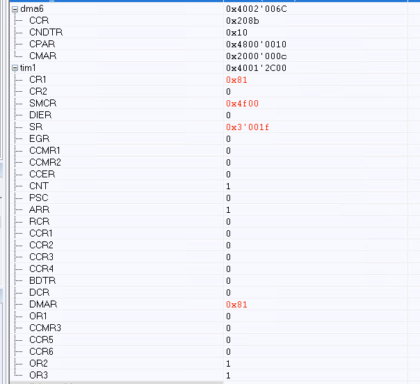

2022-04-18 1:18 PM
Read out and check/post content of TIM and DMA registers.

I wasn't sure where to set the breakpoint, so I generated a few rising edges on EFR then stopped in the while loop where these were assigned.
All are 0 except SR which is 0x3'001f, and all the lower (set) bits seem to indicate an update is in progress? Not sure how to interpret.
2022-04-18 2:31 PM
> Is this enough?
Debugger surely allows you to read out all the registers (all registers of of TIM, common and the channel-specific registers of DMA) comfortably. Post them all.

2022-04-18 3:08 PM
@Community member
Thanks for the insight.
Ok, here are all of them (image below).
However, I think I fixed it. I set the DIER bit for UDE:
TIM1->DIER |= TIM_DIER_UDE;
I thought CubeMX setting to TIM1_UP would set this bit, but apparently it did not. When I set this bit before while(1){} I now see the data from D0-D7 loading into the memory space (via debugger) and the DMA interrupt being set after 0x10 transfers. Awesome!!! However, the TIM1 requires 32 rising edges, rather than 16, and changing the period does fix that, nor does enabling the DIER_TDE bit since I figured the trigger would work.
Thanks for solving my first part! Any advice on the second part?
