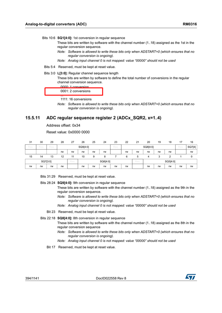

2023-05-08 4:21 PM - edited 2023-11-20 6:01 AM
> Now, adc_readings[0] contains the correct reading on every DMA transfer,
> and adc_readings[1] contains the same garbage value as before.
Now it makes sense!
Now it makes sense!
2023-05-08 4:57 PM
Thank you very much! I figured it would be a detail I overlooked. Works flawlessly now.
