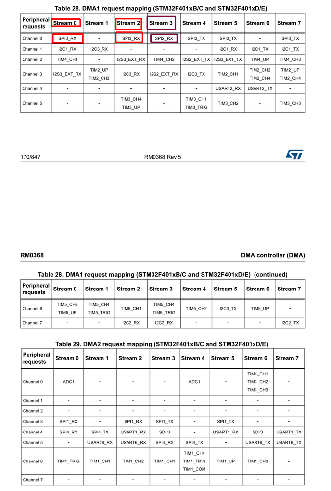

It seems that i2s module are only linked with DMA1, and other modules like TIM, ADC, are linked with DMA2. is it possible to associate one I2S to DMA1 and I2s to DMA2? It is possible paralelize streams for sameDMA controller? kind regards,T
2023-03-07 11:50 AM
> It is possible make different dma streams in parallel.
Yes.
I don't understand, how did you configure DMA for I2S2_Rx - there's no connectivity to I2S2_Rx (=SPI2_RX) in DMA1 Stream 0.
SPI2_Rx can be used only with DMA1 Stream 3.
> Is it possible to associate one I2S to DMA1 and I2s to DMA2?
No.

-I2s2 DMA1 stream 3
-I2s3 DMA1 stream 0,2

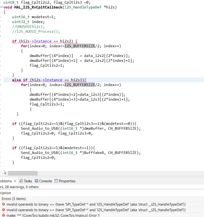

I don't use Cube/HAL, but in HAL_I2S_RxCpltCallback() you are supposed to test, from which I2S came the callback, and process only data of that I2S. Something like (again, I don't use Cube/HAL so I don't know the exact "wording"):
void HAL_I2S_RxCpltCallback(I2S_HandleTypeDef *hi2s) {
if (hi2s->Instance == I2S2) {
// copy data for i2s2
} else {
// copy data for i2s3
// and maybe send to usb here, if you are okay with this order
2023-03-08 12:42 AM

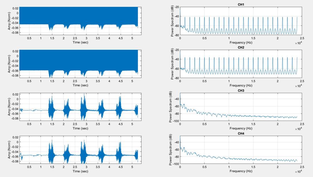

Hi @Community member ,

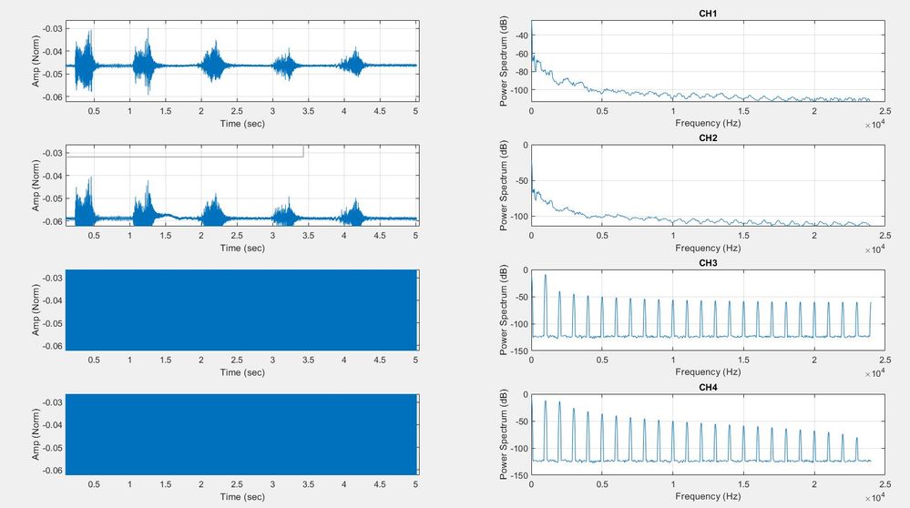

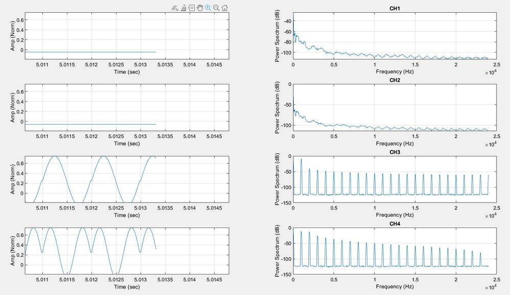

That is the behaviour with 2 i2s channels and 2 sine in ram .

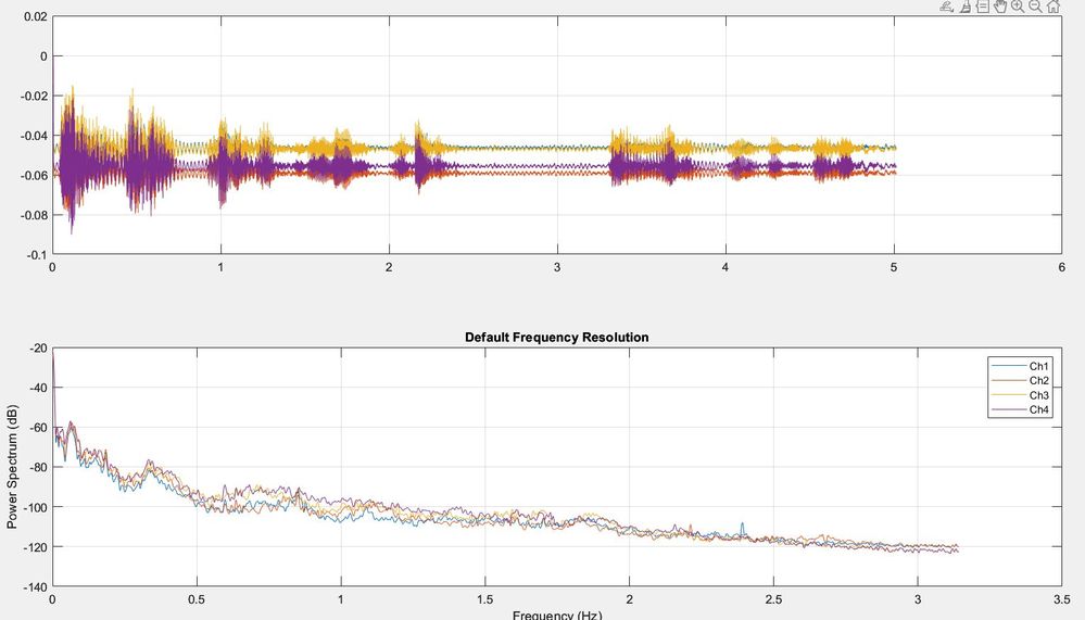

Then when i include the other i2s 4 channel are working but a bad use of HAL_I2S_RxCallback is producing some 0's in channel 1 (due to 0.5). Those produce a noise in the audio channel. Futhermore CH3 and Ch4 looks well but a iron effect is produced in the channel.
I think that including your feedback it could ork well.

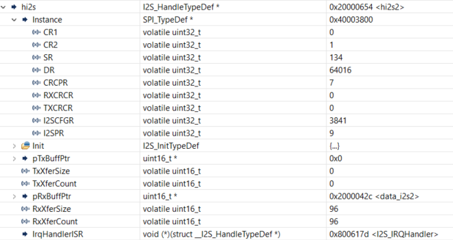

The problem is that hi2s2 is not defined and i do not know how compare this instance.
that is the struct of hi2s
I think that reparing this and including a halfconversion callback it will work
thank a lot;tcg
2023-03-08 1:54 AM
Solved
Thanks @Community member
