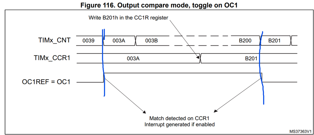

As far as I know, output compare mode keeps a value in timer registers and when counter value matches with the value in the register, then the pin generates an output according to the behaviour the user specify.
I am learning these concepts so that's why I am using output compare. I do not need pwm signal for now.
I hope everything now is correct and dont misunderstand something about these concepts. I looked at reference manual and knew these modes of timers. I then wanted to use it now am trying to implement.
