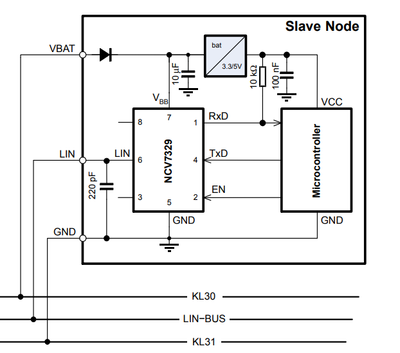

> I connect LIN Wire to IO of MCU.
I hope you did not ! LIN is 12V signal level, will damage a 3.3V cpu !
You need to connect LIN Transceiver, maybe NCV7329, and set the serial interface to LIN mode.
What speed an protocol is used, you should know from sensor or vehicle data - otherwise you cannot do anything useful.

2024-04-16 9:22 AM - edited 2024-04-16 9:25 AM
I never did...but see on git ->
https://github.com/kilohercas/STM32F103_LINBUS
set uart to ->
