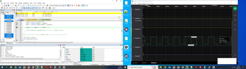

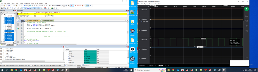

2022-09-29 1:14 AM
Output 1: ARR 65535
Output 2: ARR 0xFFFFFFFF
