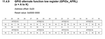

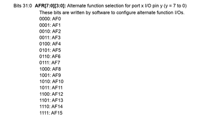

No. Cube is right. (here :) )
See rm : setting the AF ...ONE value per pin - so its ONE AF possible . dot .

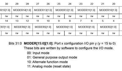

No.
see basic pin decision:
IF set to analog...you see yourself. :)

No i set primary AF 10 mode

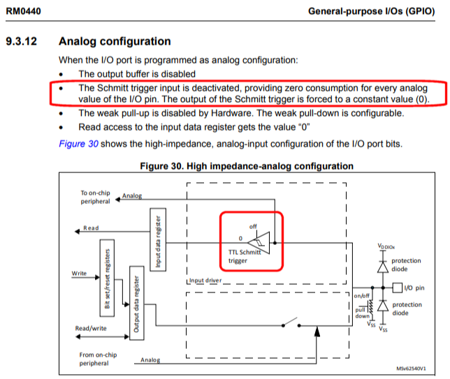

@MM..1 wrote:I agree one AF, but disagree many Analog.
I didn't say that.
I said that any analogue disables all AF.
@MM..1 wrote:As is showed on your screens analog is always connected,
But it says that activating Analogue disconnects the AF:
