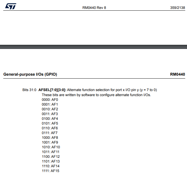

The AFSEL takes one value to select one AF - it's not a bitmap:

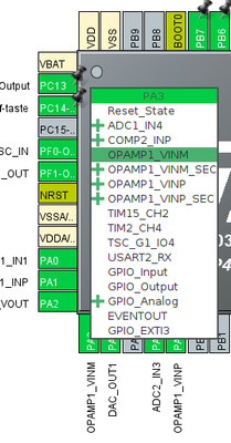

2024-07-25 11:20 AM - edited 2024-07-25 11:33 AM
just try to enable both in CubeMx , if possible you can do it ( = if both on analog mux).
see on F303, the green "+" , can use comp, adc, opamp on same pin:
(Probably same on your G431 .)
And gen.code, just look, how Cube is doing/setting...then you know, how to do.
If need set AF , say TIMx , only one AF can be set in register for AF-function on a pin.
So impossible to set the AF mux to two different values same time. (need 2 pins then, as Tesla said.)

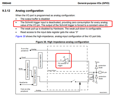

@MM..1 wrote:say one AF plus some analogs.
Doesn't selecting any analogue disable all AF ?
EDIT:
Yes, it does:
2024-07-26 2:44 AM
You see any more "+" here ? Then use it.
Otherwise you select other AF , maybe TIMx , then you have ONLY this AF.

@Andrew Neil wrote:
you can only select one AF ?

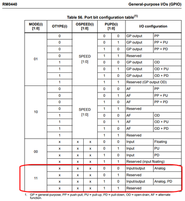

Indeed - only one:

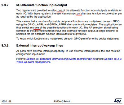

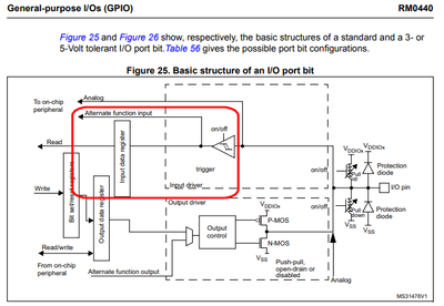

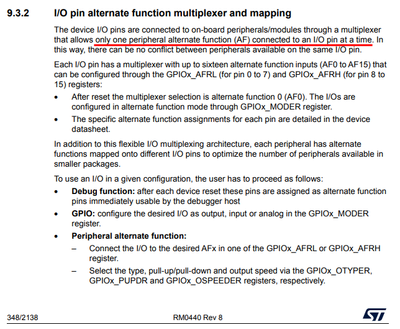

2024-07-26 2:54 AM - edited 2024-07-26 2:55 AM
@MM..1 wrote:I ask is this possible by internal hw architecture ...
No: See RM screenshots.
