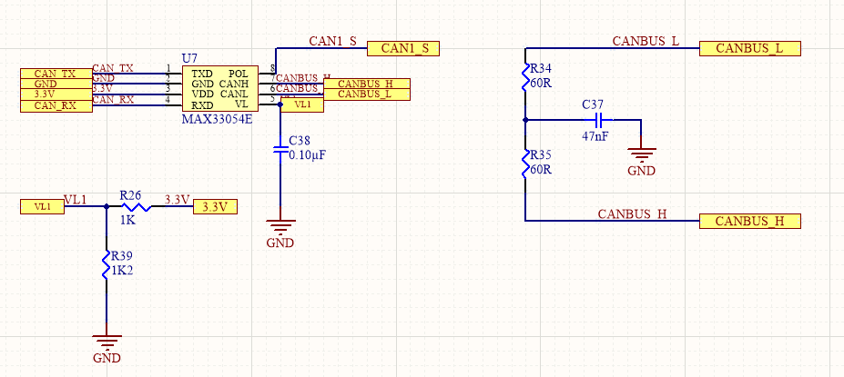

Sorry, what you've explained is hard to follow, or extract any detail from
Show circuit, whole bus with what's connected and what's listening/responding
Show code, expectations, errors and status reported
Is the bit timing correct? Is the bus on the STM32 clocking at the right rate? The connectivity parts generally clock from 25 MHz rather than 8 MHz, make sure clock and PLL settings are right.
2020-03-28 1:03 PM
Thank you for response. I have added the circuit diagram and codes below. I want to make the canbus baud rate 250kbps. I set the bittiming 80%. I have tried both 25Mhz and 8Mhz crystals. I did not get a result. I am sending a message from the Tx line and can view this signal from the oscilloscope. I can't get back to my message. Although I have removed all the filters, I cannot receive any messages from the line. Although I set the Canbus speed to 250 kb/s, the oscilloscope can decode the signal at 83 kb/s. In this case, the processor speed seems to be working like 12 Mhz.
