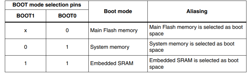

AN2586 section 3. Which binary level does a floating pin have?
2020-12-05 8:57 AM

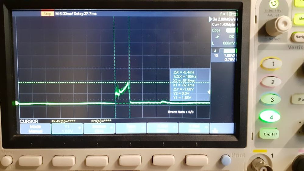

BOOT1 is not available. BOOT0 is left floating.
When power supply is given, at BOOT0 pin , a high pulse is observed with 1.6V, 5.4ms. The snapshot is attached.
Will it cause any bootloader issue?

Pull BOOT0 low to ensure it measures as VIL as the supply rises.
Entering the loader suggests it sees VIH

System Reset works fine now after pulling Boot0 pin lo low.
Thanks everyone for your help!!
