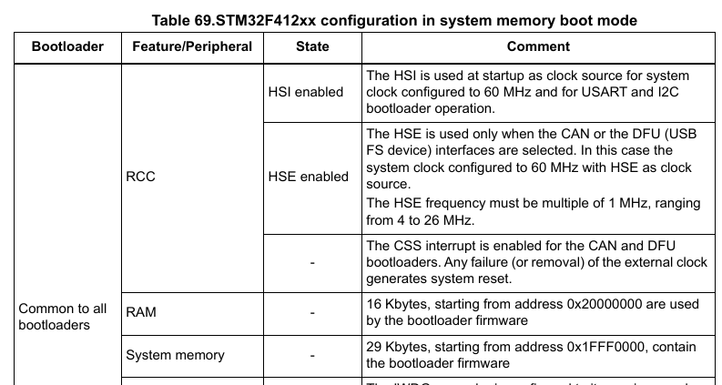

1) and 2) can be found in the AN2606 on the ST page. For my controller the relevant part looks like this:
So the address of the bootloader is 0x1FFF000 and the start address of the RAM is 0x20000000.
