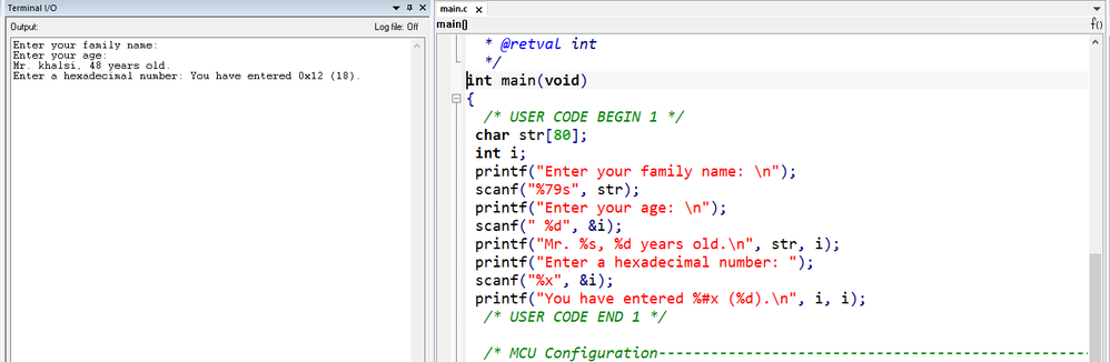

Hello @HA.5 ,
I have tested your code, It worked correctly :
I think you should entre your inputs when debug :
Foued
