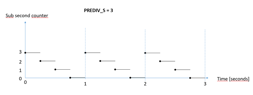

I'm using an STM32L051.
Is this how the sub second counter works in the RTC? The sub second counter always starts at PREDIV_S when a new second starts?
The graph shows a simplified example when PREDIV_S is 3.
2023-05-25 3:14 AM
Which STM32?
Yes. However, note, that reading it out properly may be tricky.
