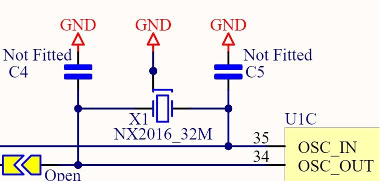

They are configurable between 12-16pF. You'll need to choose a crystal that is compatible with that.
