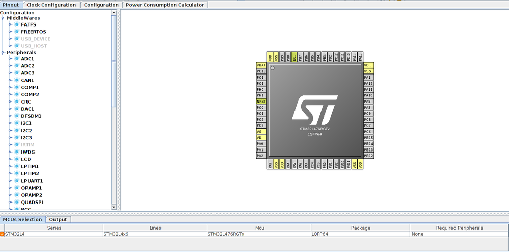

As I wrote earlier you need to generate STM32CubeMX HAL project skeleton )if you decide to use HAL or LL drivers) for GPIO, I2C, and uart. It's quite easy (enable required resource - watch out pin assignments especially for I2C because by default the CubeMX will assign other pins than those marked for SCL/SDA on nucleo board).
Add basic function for UART Transmit and send a few char to see if the PC UART sees the chars. Do the same for I2c but in this case you need I2C slave device.
Cube will add the following line to your code (I do not mention variable declaration and other staff) - just to show the idea:
MX_GPIO_Init();
MX_USART2_UART_Init(); MX_I2C1_Init();In your program you will need to add these kind of functions to play with UART:

Sir after creation of skelton from Cubemx should i import it to keil and write the code
