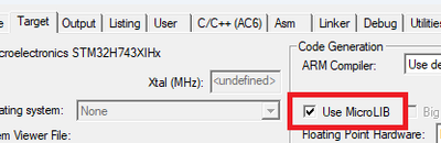

You need also to check "Use MicroLiB" option in Target:
