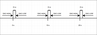

I have been struggling with creating the pattern inside the image.
Every 10 seconds I want a short heartbeat pulse generated by DAC. (DAC goes high, then low).
The period can experience a bit of jitter, no problem, but ideally it's every 10 seconds. However, the pulse is very important to have the correct timing as it is not allowed to be longer.

2025-09-22 11:05 AM
Sure.
Set up a timer that triggers an interrupt every 10s.
In that handler, set up a 2-byte noncircular DMA -> DAC transfer that send the high value, then the low value 35us later. You will need another timer for this.

2025-09-22 11:31 AM
No necessarily - the same timer can be "recycled" for this purpose with some extra programming.
And, expanding on this idea, the same trigger signal could be also used to trigger a second DMA channel through which the timer would reprogram itself so that it generates both the 10s and the 35us pulse in succession, without software intervention. Not trivial, though, and I haven't thought through all the possible pitfalls.
2025-09-23 10:16 AM
Got it to work and the code became quite minimal as well. Thanks!
