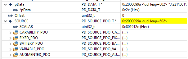

2021-04-15 5:33 AM
This is how the debugger shows the variables
2021-04-15 5:34 AM
2021-04-15 7:33 AM
In Cortex-M0/M0+, you must meticulously obey alignment.
This, the CM0(+) does not permit spanning 32-bit read/write access, other CM families will tolerate misaligned LDR/STR, but not LDRD/STRD
In your code example both [r7] and [r3] memory accesses must occur on 32-bit (4 byte) address boundaries.
If sizeof(PD_SOURCE_PDO_T) is ODD, the first set of data might work, the second set will not.
0x2000099A fails the alignment test
Suggest also you implement a proper Hard Fault Handler that can output diagnostic info. I've published these multiple times to the forum.
