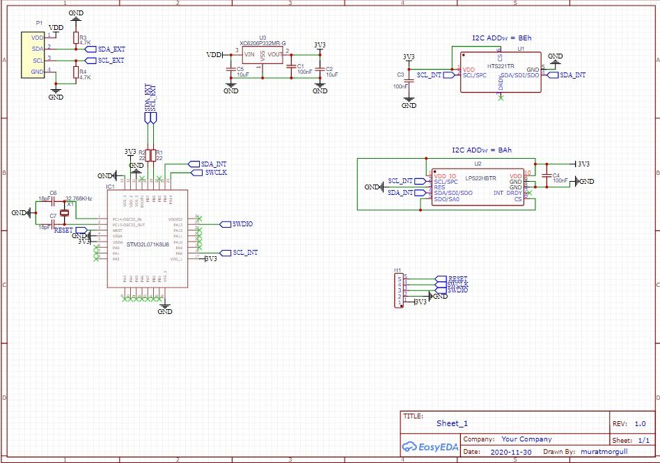

We designed a very basic circuit to test an idea. We chose STM32L071K8U6. Because, It met our needs well.
Schema

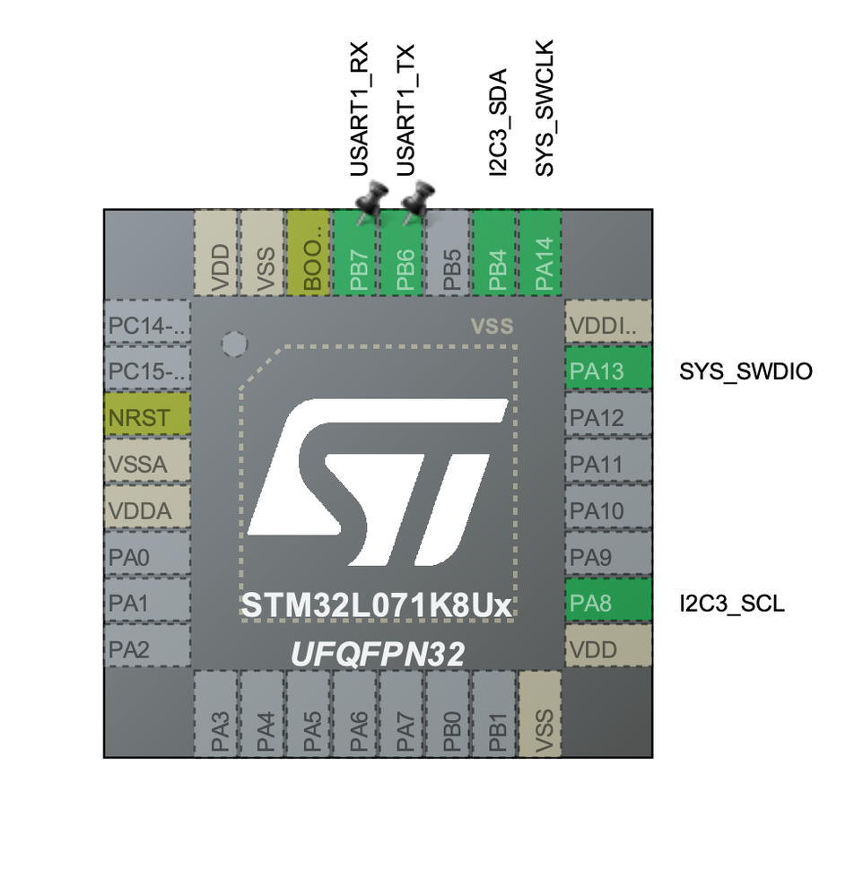

MCU Pinmap

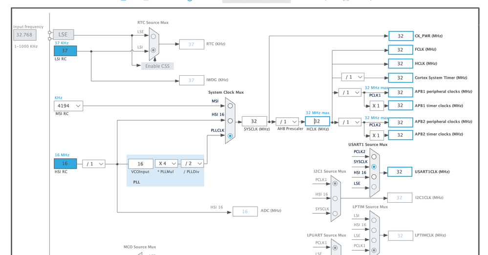

MCU Clock config in STM32CubeIde
If you look at the clock settings, this processor does not use an external resonator. It currently provides a builtin 16mhz internal oscillator.
We can upload programs to the processor via SWD. However, we cannot use peripherals.
The program often freezes on lines like MX_USART1_UART_Init () or MX_I2C3_Init ().
It seems like a clock setting problem but we couldn't find a solution.

2021-04-14 3:23 PM
You can try to set clock above 16M.

Hi, thank you for the answer.
When I set the clock to 32Mhz (max) or 24 Mhz. It gets stuck on in SystemClock_Config
Exactly below lines in generated SystemClock_Config function.
RCC_ClkInitStruct.APB2CLKDivider = RCC_HCLK_DIV1;
if (HAL_RCC_ClockConfig(&RCC_ClkInitStruct, FLASH_LATENCY_1) != HAL_OK)

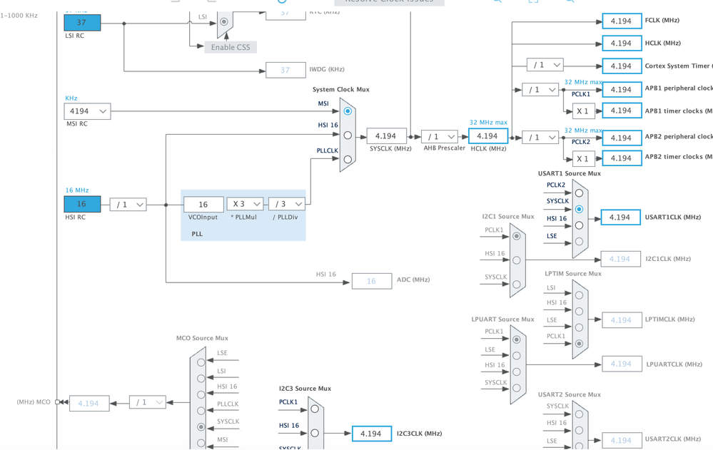

2021-04-14 5:40 PM
It's really weird. Can only work at your initial clock frequency 4.194M??
2021-04-15 9:54 AM
I also tried increase speed up to 32 Mhz.
But, unfortunately code stuck below line in SystemClock_Config()
if (HAL_RCC_ClockConfig(&RCC_ClkInitStruct, FLASH_LATENCY_1) != HAL_OK)I didn't write any custom code yet.
2021-04-15 10:10 AM
All very odd
FLASH_LATENCY_1 should be adequate for 32 MHz at 3.3V
Is the part Hard Faulting?
VDDIO2 is only for PA11/PA12 as I recall
Circuit looks simple enough, resolution if image is poor
I'd start with the supplies, probably add some bulk capacitance near-in
2021-04-15 5:26 PM
I mean,you can try to make a new project to confirm the function SystemClock_Config can only work at 4.194M? Maybe it's not the frequency of modification.
