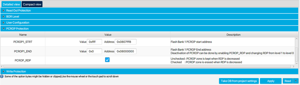

I wanted to do a full chip erase using STM32Programmer (I am trying to debug a custom bootloader) but kept getting the error "Mass erase operation failed. Please verify flash protection".
I sent the following option byte screenshot to ChatGPT....
ChatGPT said...
In your PCROP Protection section:
PCROP1_STRT = 0xFFFF
PCROP1_END = 0x0000
PCROP_RDP is enabled
This is an invalid PCROP range: start at 0xFFFF, end at 0x0.
That effectively protects a huge chunk of flash against erase/program.
So even though WRP and RDP are fine, PCROP is blocking your erase.
In STM32CubeProgrammer → Option Bytes → PCROP:
Set PCROP1_STRT = 0xFF
Set PCROP1_END = 0xFF
Uncheck PCROP_RDP unless you specifically need PCROP linked to readout protection.
Apply changes (Program Option Bytes → Reset).
Retry Full Chip Erase with ST-Link.
I did the suggested fix but it obviously didnt work.
But worse still, I cant even change the option bytes back to as they were because I get the following error....

18:45:49 : OPTION BYTE PROGRAMMING VERIFICATION:
18:45:49 : Error: Expected value for Option Byte "PCROP1_END": 0x0, found: 0xFF
18:45:49 : Error: Expected value for Option Byte "PCROP1_STRT": 0xFFFF, found: 0xFF
18:45:49 : Error: Option Byte Programming failed Or modified by application after OB_LAUNCHI cant program or debug in STMCubeIDE either so Im worried my board is bricked.
Is it recoverable and if so how ?

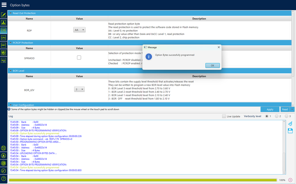

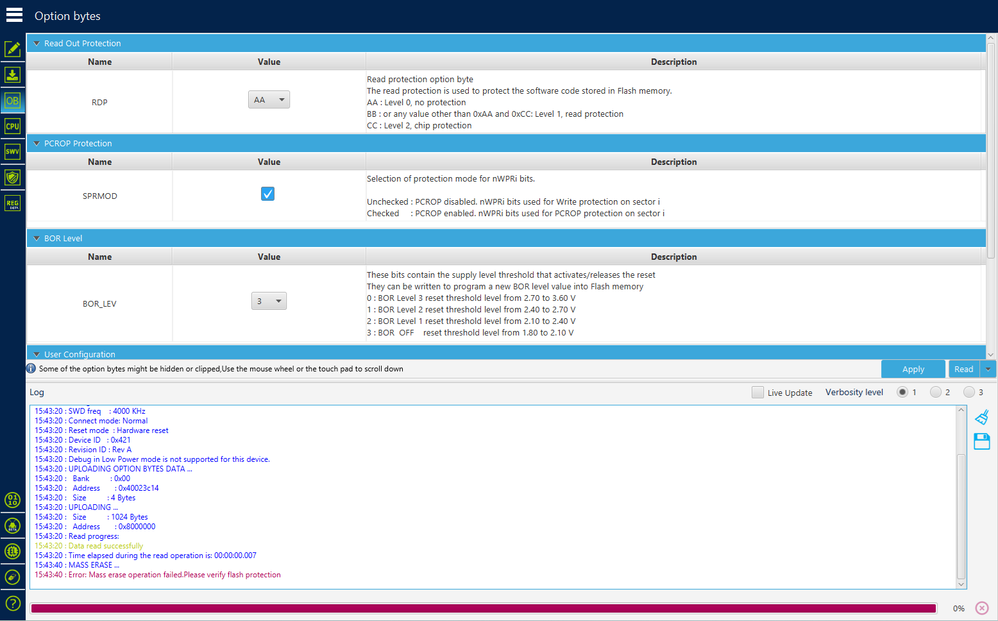

It is hard to figure out from descriptions but see here, SPRMOD is enabled and I cannot erase the chip. See the the test below it fails to erase.

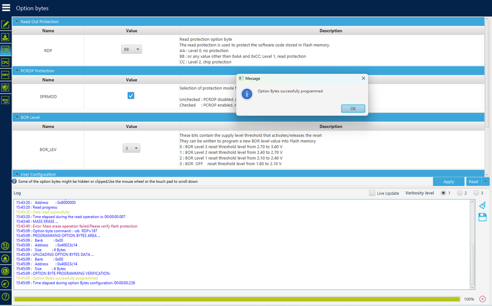

here is the tricky part you have to change RDP to BB, becasue it does not allow just uncheck SPRMOD now, click apply
then you check RDP back to AA and uncheck SPRMOD and click apply

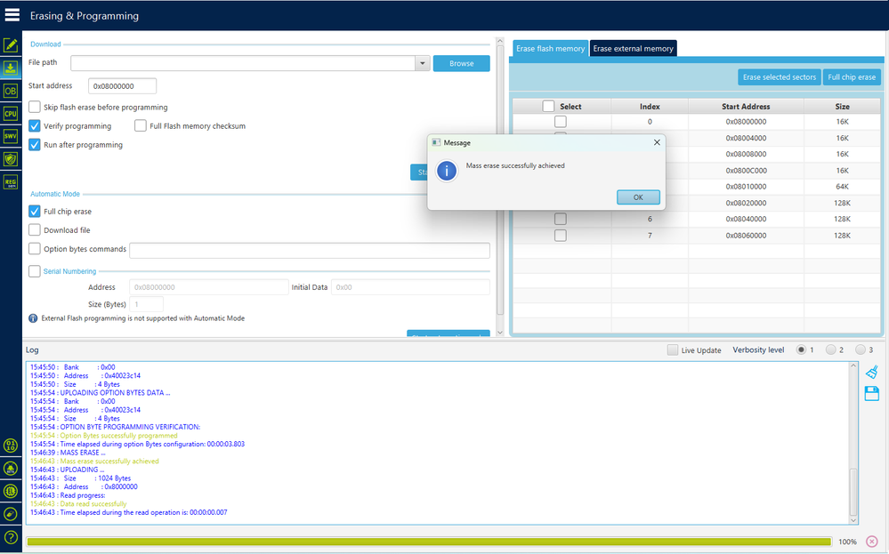

now you have SPRMOD unchecked and you can erase now
probably that was the problem, a little tricky to disable but it can be done.
