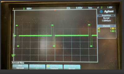

This is the waveform of the oscilloscope.

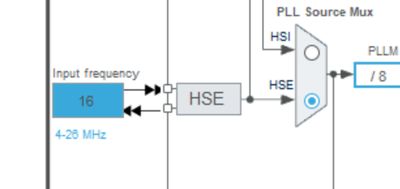

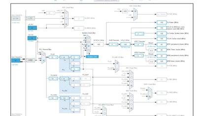

In the clock tree settings, I only switched the clock source to HSE, and the divider settings did not change. I wonder why this happened.

Change HSE to 8 MHz if that's what's on your board.
You don't mention your board, but most of the ST boards have this as 8 MHz.
