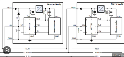

I see by the datasheet that USART1 can be used as a LIN bus directly without a LIN bus transceiver, but I can't find any examples of how the hardware is implemented when that's set up. My assumption is that I need a 1kohm pull up to Vcc on the master and a weaker pull up on the slaves, connected to USART1_TX and leaving USART1_RX floating.

RX and TX to the rx tx pins of the LIN transceiver...

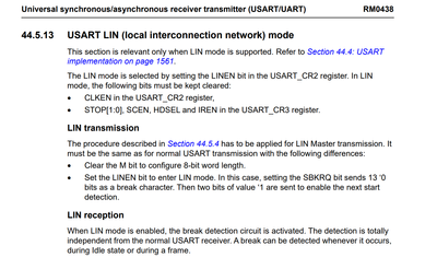

just try in Cube: set the uart to LIN-mode and see, what it changes on rx + tx hardware. (nothing.)
read in rm :
So you get LIN break detection etc , but there is no LIN transceiver built in the cpu.

Just connect it to the transceiver, as you did it on your system up to now.
