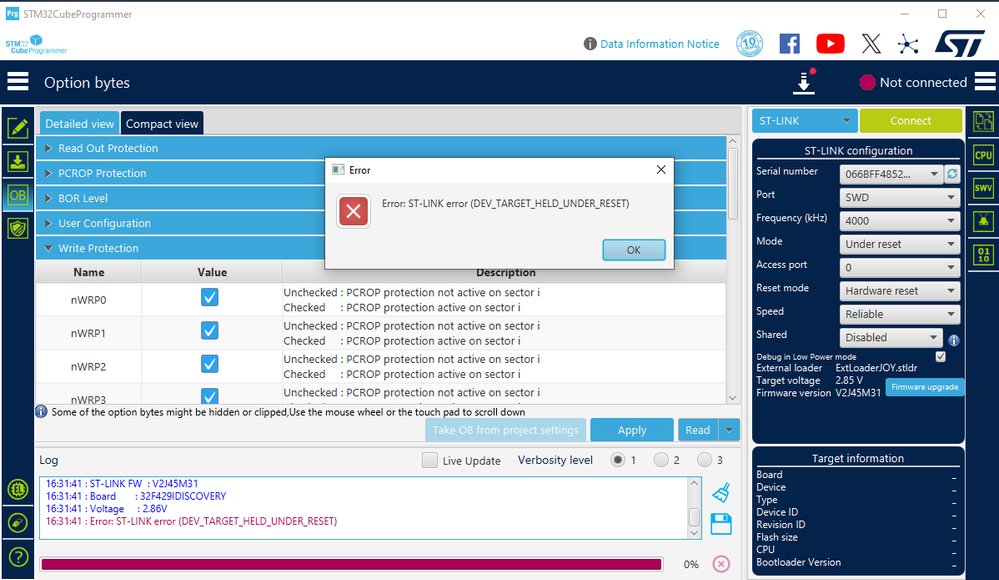

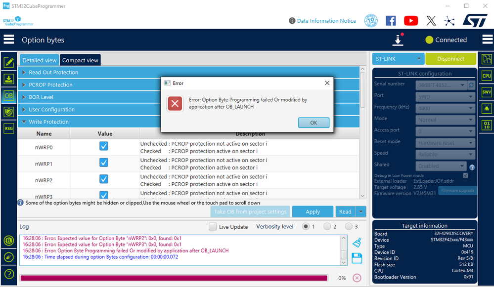

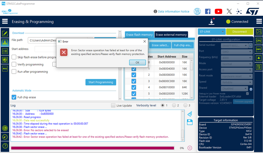

Hello @TDK ,
I apologize, When i try to disable the WRP I am getting this error.
And also when i try to erase the chip, this error is generated.
When i try to connect the device by changing the mode to 'under-reset' and holding the reset button this is the generated error.
2025-03-12 6:21 AM
Not real sure.
You have this board, correct?
https://www.st.com/en/evaluation-tools/32f429idiscovery.html
The flash size it's reading out is incorrect. I have an older version of this board and it works fine there.
Do you need the external loader? I don't think this board has additional on-board flash memory.
Are you on v2.19.0 of STM32CubeProgrammer?
