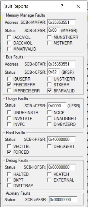

I config UART on interrupt, after receving data on UART simple sending data at that time hard fault occur.

HAL_UART_Transmit(&huart2, response,11,200);After that... If any once has any suggetion let me know or also tell me how to debug hard fault or any exceptions.
