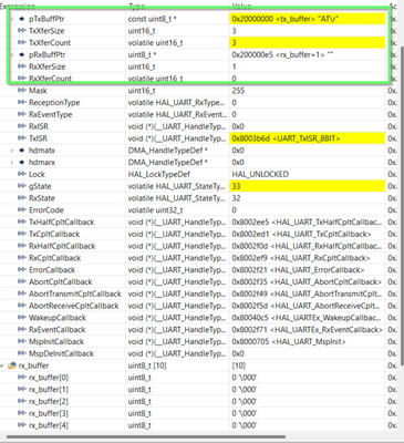

@KnarfB Ok so I've unset register callback for the usart/uart. Still not data is being shown in the buffer, and the HAL_UART_RxCpltCallback is not called. In the HAL_UART_IRQHandler this if statement gets skipped.
I attached the _hal_uart.c for reference.
2023-10-29 7:42 AM
is rx_buffer a global variable? The pRxBufPtr variable in your above dump has advanced one char position, so something was received?
HAL handler should call UART_RxISR_8BIT which in turn calls your callback. Check error bits.

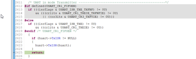

In the UART_RxISR_8BIT function, the huart->RxCpltCallbacl(huart) gets called, but it happens only once and only goes straight to the return statement, and not the if statement.

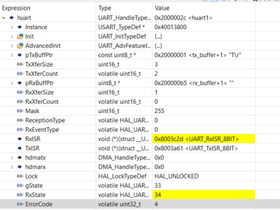

In terms of error bits, is that taken from the huart instance? For example why debugging the huart in the Live Expressions the ErrorCode is 4.
I believe this is a framing error response, as the UART1_IRQHandler() sets it and has a break point there:
2023-10-29 8:58 AM - edited 2023-10-29 9:00 AM
"huart->RxCpltCallback(huart) is called" Then, USE_HAL_UART_REGISTER_CALLBACKS is still defined. You may regenerate the code to let HAL_UART_RxCpltCallback(huart); be called. The weak default implementation will be replaced by the linker by your function of (exactly) the same name.
The interrupt is only one-shot after HAL_UART_Receive_IT. You have to call that again at the end of your callback.
