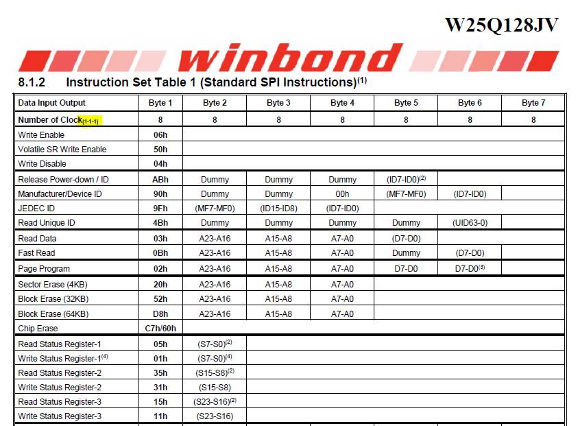

Hi @diverger ,
I found different info that you may want to check: according to the W25Q128JV datasheet, the read status register is only in standard SPI mode (1-1-1).
For more details, please check the W25Q128JV datahseet , in sections:
Imen
