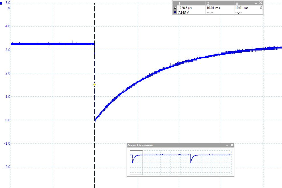

And yes, reset is executed, here is the scope capture for a reset pin:
The first pulse is reset in application, which provides jump to a bootloader.
The second pulse is a reset in a bootloader before the jump to an application.
The capacitor to the ground at a reset pin is 0.1 uF, nothing drives the NRST pin externally.
It seems to me that pulse may be too short to reliably reset a controller, but I don't know what is possible to do with that.

NRST is connected to the ground by 0.1 uF capacitor.
Reset is executed - see the capture above. The pulses in it are caused by SystemReset() calls.
2019-01-22 5:27 AM
OK, I've checked again. It seems like in cases when there no reset occurs, there are no pulses at NRST.
It means that SystemReset() is either not called or it's called but reset is not executed.
Will check this.
