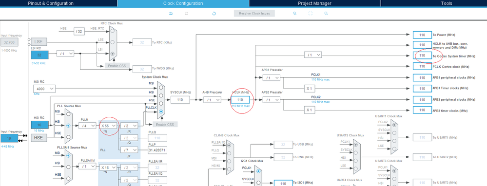

Hello Tesla,
After your explanation I try to have 110 MHz, it's ok but I don't understand what do you mean prescaled clock source is DVI8 ? I have this configuration can you show me this prescaler on this picture please ?
it seems to me that I have a prescaler of 55 to have 110 MHz.
2023-03-10 1:24 AM
You IOC file shows the System Tick at priority 7 when by default it is 0, though that is still probably not the problem.
Set a breakpoint at HAL_IncTick() and see if it gets called?
