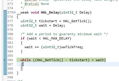

I tried the Hal_Delay function but it's not work Do you have any idea for this error ?
And my code still waits at this loop :
Thank you for your helps

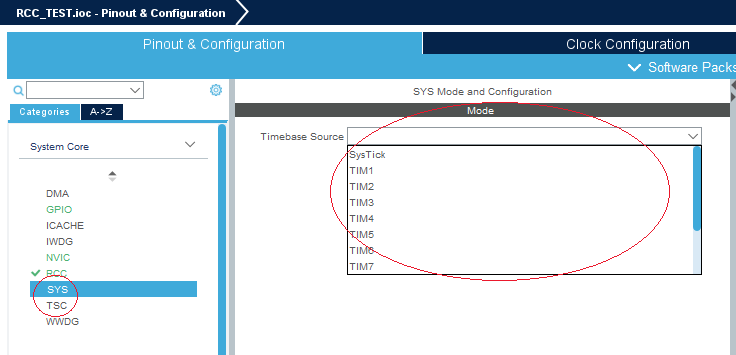

2023-03-08 6:53 AM
I'm not familar with the code (I'm a new user), I prefer to go through Cube IDE. I suppose it's this tab I need to activate ?
And I select SysTick probably ?
no parameters to be configured ? What does that mean ? I specify that I have an evaluation board STM32L552E-EV.

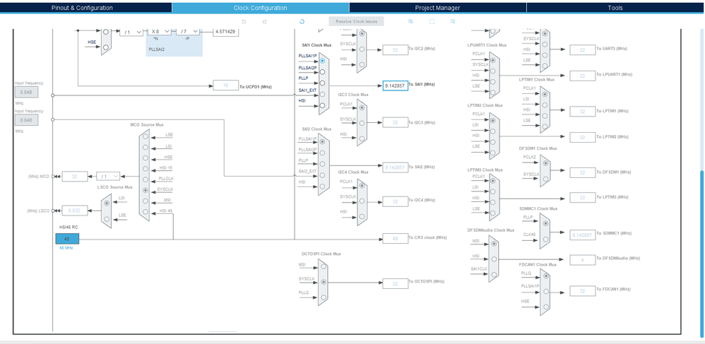

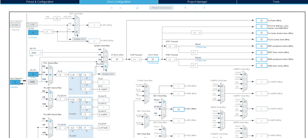

2023-03-08 7:54 AM
Sorry I don't know how to upload .IOC file but I can give you the screenshot.
2023-03-08 7:57 AM
