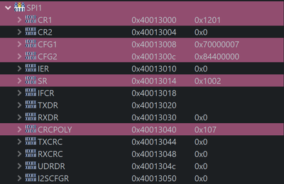

2023-12-01 6:24 PM
Try this. Works for me on H723 just now.
You might be getting a MODF error with your code, although your register printouts at the first post don't show it.

If that doesn't work, show your registers with your latest code. Should be this at the end of the above sequence:

2023-12-01 7:39 PM
Looks like it's working then. My debugger is reading RXDR which is the difference in SR.
