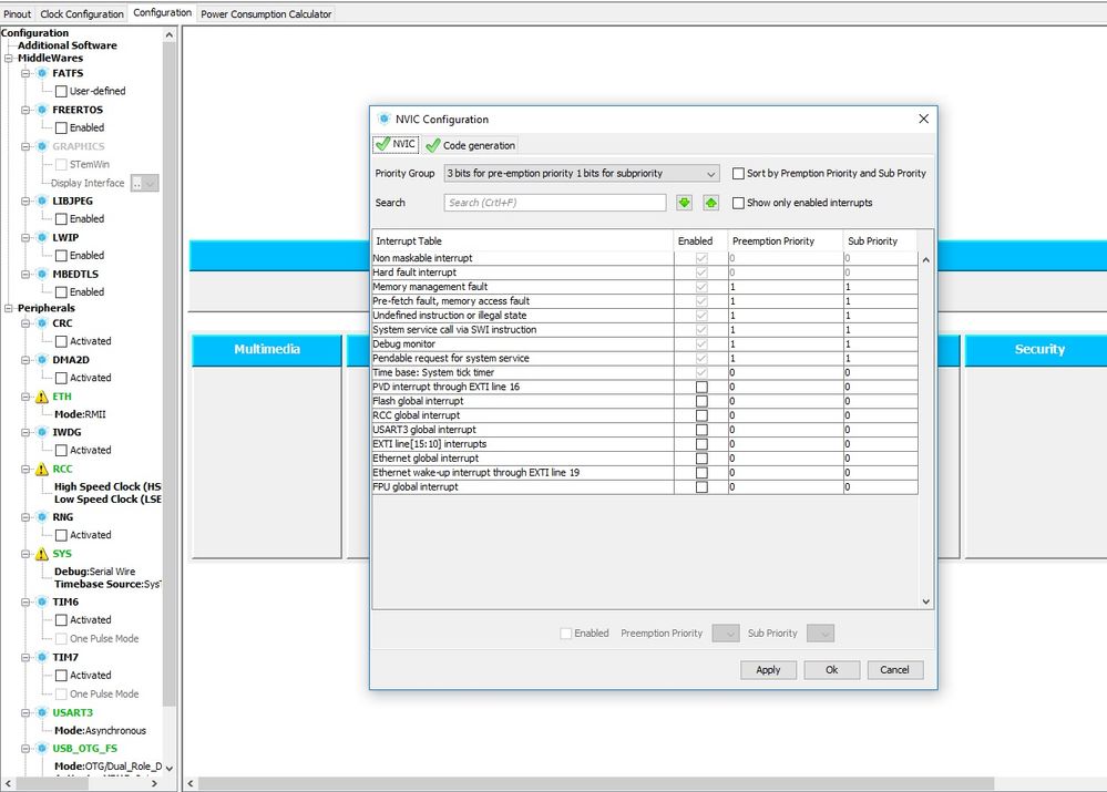

I tried to change priorities through STM32CubeMX, then I put a screenshot where it is observed as in theory Systick has higher priority than the rest but still nothing works.

This is among many reasons that most of the programmers here aren't using CubeMX, but I wish you luck.
Use tools that allow you to find-in-files, and go to definition, or use a file manager that allows easy searching.
Code in HAL_Init() typically brings up the SysTick interrupt.
